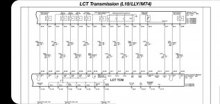

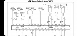

Like Brad said, if you unplug the main harness it will go to a default mode and give you 3rd / Reverse if everything mechanically is in order.
And I've also seen recently where a TCM was causing open circuit codes and shifting problems
