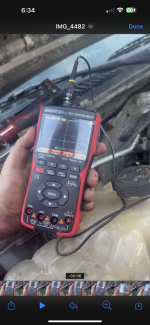

I think your reading should look something like this. But at 96 volts peak. You might have more variations and kickback spikes but something similar

Also would I just be best off just pulling upper valve covers and testing right on the solenoid studs on top of injectors or just how I did before and just unplugged injector harness and hooking up that way?
6,887
2,095
If you unplug the injector harness the ficm will detect this and shut down the whole bank. Thus ruining your testing
So, either poke needles into the lines or back of a connector and measure there or pull a valve cover
