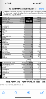

I just had my oil tested and they found no traces of coolant in the oil. Thermostats were just replaced to rule that out also I had a leak from the oil cooler which was fixed. I’m really thinking I have a head gasket issue. Any info / thoughts would help. I really don’t think it’s the cap either. Radiator was just replaced not to long ago as well
