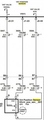

I’m unsure where this plug goes. When I took my truck apart I thought I labeled every plug but this one was missing one. The plug comes off the main harness and one plug goes to the sensor under the harness bracket and not sure where this plug goes.

Vane position sensor. I don't see the white wire running down to the sensor
Maybe that I don’t have a vgt turbo so that maybe it. I guess I’ll just have to see when I have everything back together and see if anything is missing a plug

It looks like the vgt wire to me so if your running a fixed geometry turbo i think you have it figured out.
