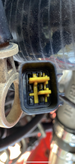

Hi does anyone know where this connector plugs into ?
Has red white and black wires

Might be the Fuel Rail Pressure sensor sub harness connector. The sensor is at the end of the right rail. It has a small pigtail harness that connects to the main harness.

It looks like the connector that connects to the sub-harness that runs down behind the coolant crossover/thermostat housing above the water pump along the upper oil pan rail to the oil pressure sensor and oil level sensor.
