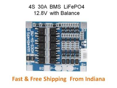

I would like to know what BMS and what resistor you are using.
the resistance is not too important. as long as its in the range to pass less amps then the BMS can handle and within the wattage range of the resistor. I think mine was 5 ohms
